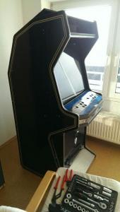

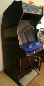

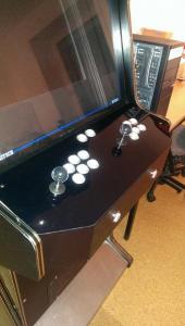

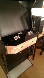

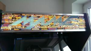

TobsenFI Posted November 3, 2014 Posted November 3, 2014 Hey there, Just want to show you my cabinet, working still in progress. Origin: Magnum Hitech Uni. Cabinet What did i do: - The Orginal Screen was broken so i had to remove it - Mounting a 19" TFT and cuting a new bezel - The original Controlpanel is a steel one with an terrible layout so i decide to build a new one out of wood with an japanise standart layout - PC and Emulation HS programming - lamination with black sheet of the cabinet it self - new marquee from gameongrafix lighted it up with LEDs - cut and drill black plexi for the controlpanel - mounting and wire of new LED Pushbuttons and two Seimitsu LS32 Joysticks So what should i do with the sideart ? Something minimalistic would be nice.
BoOgieman Posted November 7, 2014 Posted November 7, 2014 Looks good! So what looks clean for the sides you ask? I would stick with some simpe white or silver striping... Also I would have chosen a different MAME marquee, one without the heavily colored background. What do you think? HyperSpeech - Text-To-Speech Voice Addon for HyperSpin

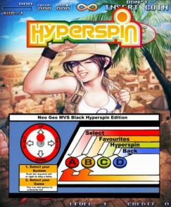

TobsenFI Posted November 16, 2014 Author Posted November 16, 2014 Thanks Boogieman, As a big fan of The Neo Geo Games i decide to make a Neo Geo Black Edition Cabinet. Marquee drawings almost ready .. almost. -Minimarquee is repainted to Hyperspin but iam not sure with the backround in it. What you see is only a test backround . Did any one have a suggestion ? -Sideart is in my mind allready but not painted. Standart MVS Logos with red stripes and a SNK Character.
