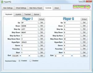

The JPac should come programmed with the correct keys already in it. It also uses the [Player 1 Start] as a shift key, so the setup should just work.
To program your keys in HyperSpin, it is entered into the HyperHQ.exe program in the same directory.
Launch HyperHQ.
Click on the Controls tab on top.
There are all the control keys that you might need to:
