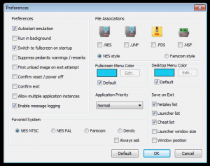

mameshane Posted January 11, 2013 Posted January 11, 2013 latest hyperlaunch is 2.25c.. check that your settings match this image. if you have these settings already, update to hyperlaunch 2.25c and try again, if it still doesnt work, post back your hyperlaunch.log. My Cab.. 1-UP ARCADE new hyperspin irc details.. come hang out!
evh347 Posted January 11, 2013 Posted January 11, 2013 latest hyperlaunch is 2.25c..check that your settings match this image. [ATTACH=CONFIG]23030[/ATTACH] if you have these settings already, update to hyperlaunch 2.25c and try again, if it still doesnt work, post back your hyperlaunch.log. My Nestopia setting look just like yours. Again, Nestopia is launching to a full screen, a blank screen (outside of HS). If I resolve why its doing that, then launching from HS correctly will solve the problem.
