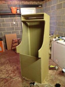

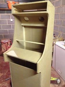

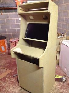

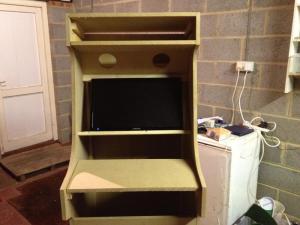

Hello All,
This is my first post to the forums, so not sure this is in the right place (apologies).
Let me start by thanking you all for the invaluable source of info during the build of my first cabinet, many thanks!
I thought I'd post a few pics of the cab, very much in its raw state, but its been fun documenting the process, so why not share...
Im getting to the point of adding sticks and buttons now, and have a specific question regarding button mapping that I cant seem to find an answer too. Basically, I want to have a save and load state button as part of some admin buttons on the cab, but am struggling to assign a button command to a single keystroke from all the different emulators. Its OK for MAME and 7SNES, as you can manually assign the buttons, but for emulators where the hotkeys are preassigned, I need to be able to map lots of different keys to the same key, if that makes sense??
I.E, Fusion uses F7 to save and PCSX uses F1. I need to be able to map both of those keystrokes to a single key (i.e "S"), so I can wire the save button and have it work on all emulators. I have tried a couple of pieces of key mapping software and they only seem to let me map one key to another, not multiples??
It must be possible, and any feedback on the cab is more than welcome!
