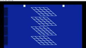

rexryan Posted February 7, 2015 Posted February 7, 2015 your seeing a menu bar in mess when running hyperspin? can you post a screenshot?

Capa Posted February 7, 2015 Author Posted February 7, 2015 there is a hide menu option under file, but will only hide during that game session and will reaper next time loading mess.
pinsanity Posted February 8, 2015 Posted February 8, 2015 Open your mess emulator folder. Find the folder labelled "ini". Open it. Find the the mess ini settings file and open it with notepad or similar program. scroll down until you find a section labelled "WINDOWS VIDEO OPTIONS" about 3/4 of the way down. see the 2 items called prescale and menu? In your case menu will have a 1 next to it, change that to 0 (as in zero). Save and close the ini file. Restart mess. If it has worked the menu bar will be gone and SHOULD stay gone.
