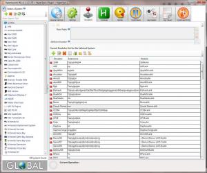

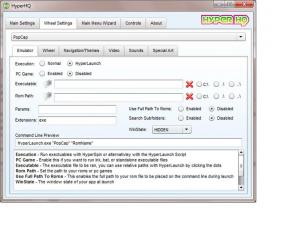

My HyperHQ has PC game disabled and the extensions as exe, here is a screenshot.

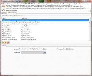

My HL has "casual games" set as the emulator with the appropriate path to my roms location. Even with these settings I don't actually have "casual games" the emulator setup as an emulator (the games still run fine though).

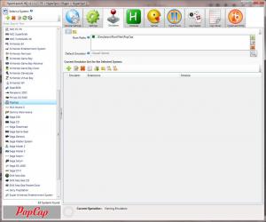

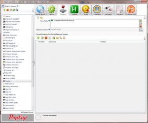

Here is my global emulators

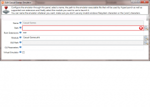

Here's what popcap the emulator setup looks like for me
