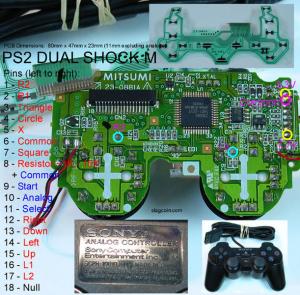

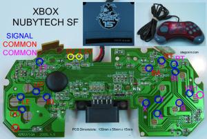

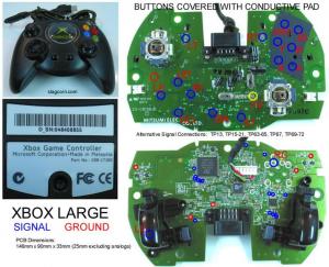

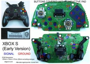

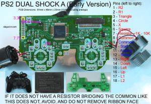

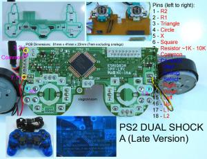

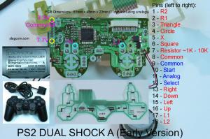

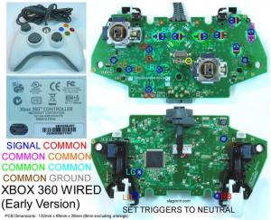

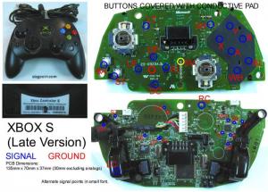

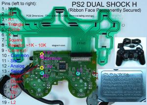

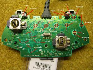

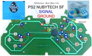

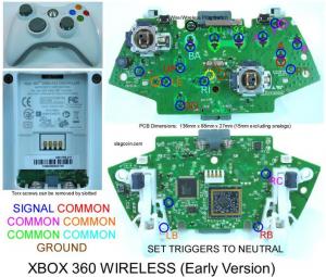

Porting a Controller to Cab (layouts)
Nexus23

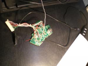

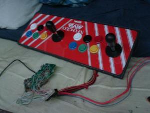

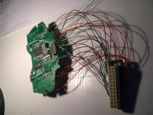

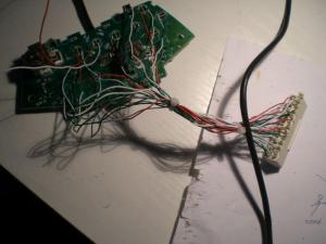

Some Pics of my very cheap X-Arcade build :) Broken Controller, a broken Board and ATX PSU for fast fitting parts.
