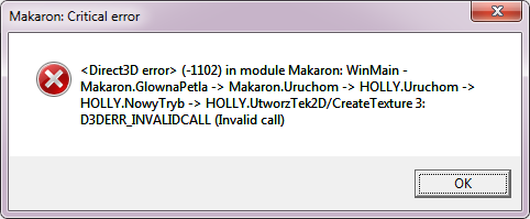

So I have been trying to get Naomi into Hyperspin and have ran into a bit of a roadblock. I originally tried to use NullDC Naomi and couldn't get it to work. Then I tried Makaron, but it is not compatible with my graphics card. I cannot upgrade the card because I am using an all in one micro pc. I don't think there is a way to fix this. I installed the proper directx package as well as C++ redistributable, but that didn't resolve it. I'm fine with this since I would rather have NullDC working.

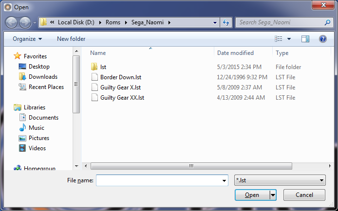

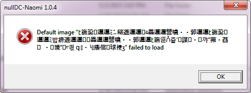

If I enable it I get the error message. If I disable it I get prompted for the file. I can then select a game and it works fine.
Prompt
Error.
Here is the AHK. What do I need to modify to get it to launch roms properly?
