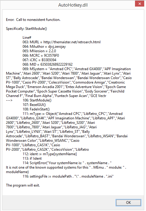

"Call to non existent function" when trying to use RetroArch
goldenegg
When trying to use RetroArch for any supported system, I get the error "Call to non existent function" and then it says "Specifically: StartModule()".  I'm using the HyperSpin 1.3.3 install from the download page, along with the RetroArch.ahk it comes with.
Here's an example of the process I'm following:
  1. Use HyperHQ to add "Nintendo Game Boy" to the wheel
  2. Set the emulator path to the RetroArch executable and select to launch using HyperLauncher
  3. Set the ROM directory, containing non-compressed ROMs (*.gb)
  4. Copy the RetroArch.ahk module to the new Nintendo Game Boy folder and rename to "Nintendo Game Boy.ahk"
I'm at a loss trying to figure this out.  Any help is greatly appreciated!
EDIT:
I got it working by moving over to RocketLauncher.
