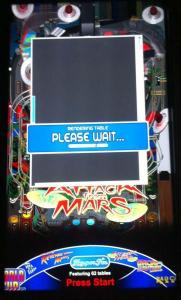

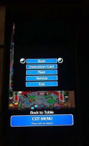

  7. OK, I'm using "e" instead of "ESC" now. It really seems to work much better! No more weird problems when pressing the exit button! I also noticed that somehow my pinmame.dll was overwritten with the non-cabinet version - I replaced the .dll file with the cabinet-version of it and now I do not see the splash screen anymore. So all is working well now! I still have two problems when using FuturePinball-tables: 1) It happens that when starting a FP-table, the editor window of FP could be seen in the background (between HyperPin frontend and the "please wait" display). Can this be hidden in some way? 2) The graphics right under the exit menu (when I press "e" for menu/pause) is black instead of the graphics of the table in the background. Is there a way to fix this glitch? I still do not understand the thing with AHK: When I'm using the compiled exe of FPLaunch only I do not need to install AHK 1.048.05, right? Using Win7 x64 here! Edit: Enclosed two pictures of the two problems I have with FuturePinball. Edit2: After some trial and error I noticed that FP freezes HyperPin now and then after pressing the exit button (in my case "e") short and exit via menu or long with the countdown. After the freeze I can only use the taskmanager to kill all tasks. This is not good for a cabinet...
