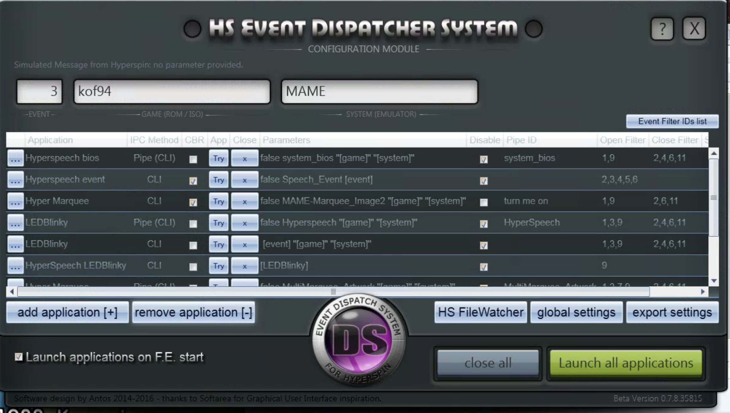

  • Location

  1. Believe it or not, I am still having the same issues. So I can see that when I exit a game, it makes the marquee screen the dominant one, hence why HS freezes and a mouse click on the main screen will resolve the issue. I have posted on other media like YouTube and was advised to 'Change the exit method to alt f4 in the module settings tab' but I am not sure what settings tab the guy was referring to and unfortunately hasn't responded to me response. I was looking to start from scratch with the new HS V2 but this doesn't look to have support for Hyper Marquee yet. if you have any other ideas, please do let me know Thanks

  3. What I have now found is that each time a marquee loads, it is loading in a new window. So after a while I could have 10 marquees open. This is likely what is taking the focus and the reason the pc slows down after a while. Just need to work out why it opens in a new window and not just change the marquee with the already open Hyper marquee

  7. That’s for taking your time to send this. I’ve checked and the setting look the same (within reason) however I have foind that if I create a new marquee set, it works and HS doesn’t freeze. However, it still loads the old overlay so I need to kill that first. Just trying to work out how to disable that marquee set as even when I set a new one as details. When i restart the arcade it returns. i do feel like i am setting somewhere and will continue tomorrow
