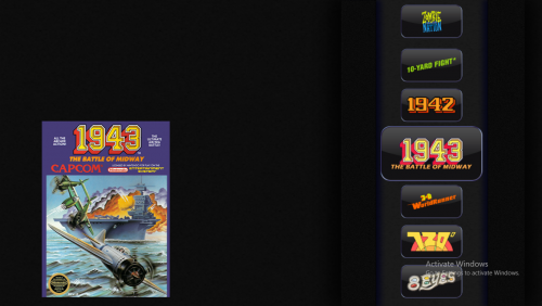

Tired of batching with photoshop? This script will shrink any number of images within a file to constrain the width and/or height to beneath a specific size (default is under 200px wide and/or 100px tall. Then, it will attach it to a background image, which can be anything you want. The default tile included is is Chicuelo's theme. Super easy and FAST!

_1_shrink.py will shrink the width and/or height under the specified dimensions while maintaining the aspect ratio. Variables can easily be adjusted within the script.
_2_combine.py will open your _Background.png and attach and center each image within the folder, and overwrite the existing image with the new background.
_3_width_75percent.py shrinks the width of each file in the directory for widescreen displays.
