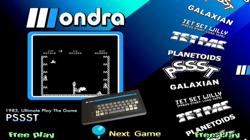

Another system that nobody asked for and nobody needs!
An obscure Czechoslovakian computer from 1985.  Only five games for this one and they are all black and white Spectrum ports.  The games don't have sound (unless you count the horrible screeching of tape loading).  I'm not sure if these games actually have audio.  Mame lists audio as functional and the only gameplay videos I found on original hardware were without sound.
By default, all games load to Ondra BASIC and simply pressing Enter (start on controller) will begin the tape loading process.
But that's not good enough! There is a way to launch directly to the loaded tape for all but one game (Jet Set Willy)
The usual save state (autoload) method will not work, but the alternate autosave method will.

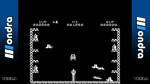

Here are the correct times to exit the games and successfully make autosaves
galaxian - Exit from title screen
jetpac - Exit on gameover screen
planetoi - Exit on title screen
psst - Exit on gameover screen
jetset - This game will not correctly save! Exit before loading a tape to create an autoload. The autoload will basically do nothing and you have to press Enter/start and manually load the tape every time.
I set Main CPU Overclock =150 on Galaxians and uploaded the galaxian.opt
