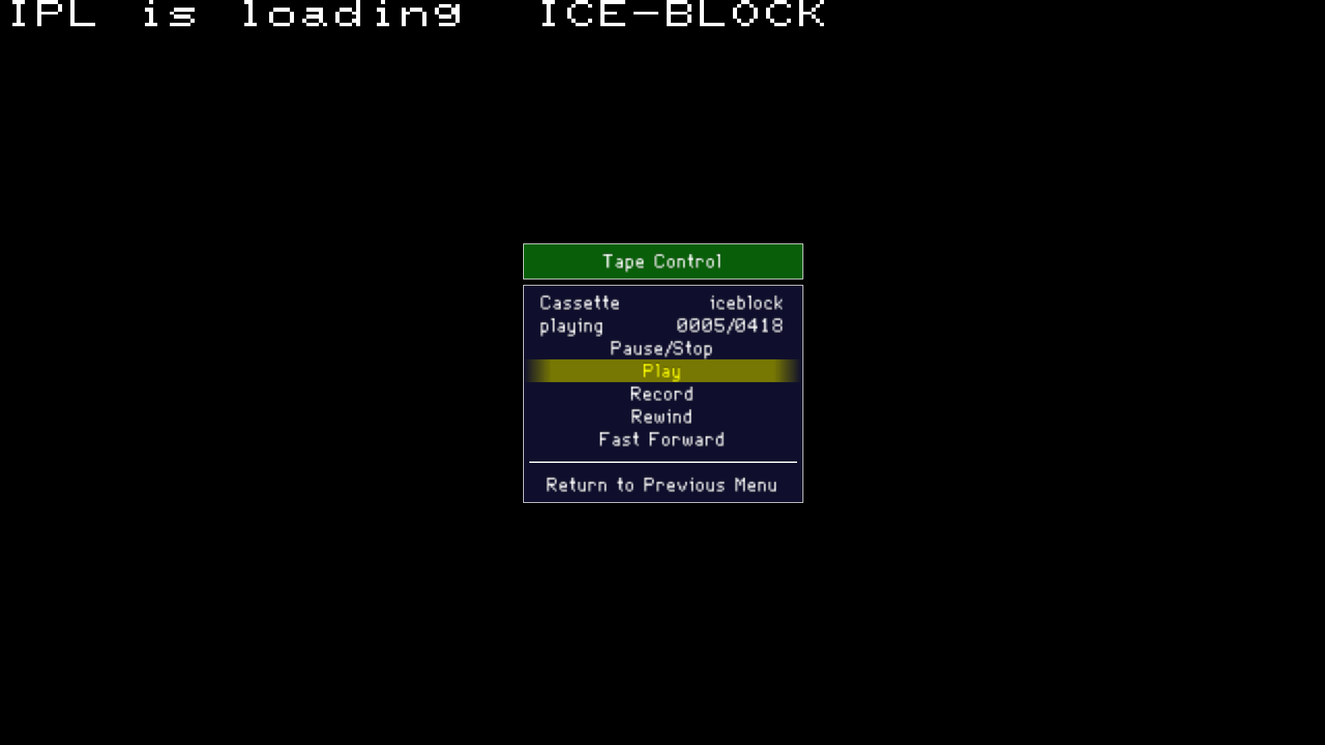

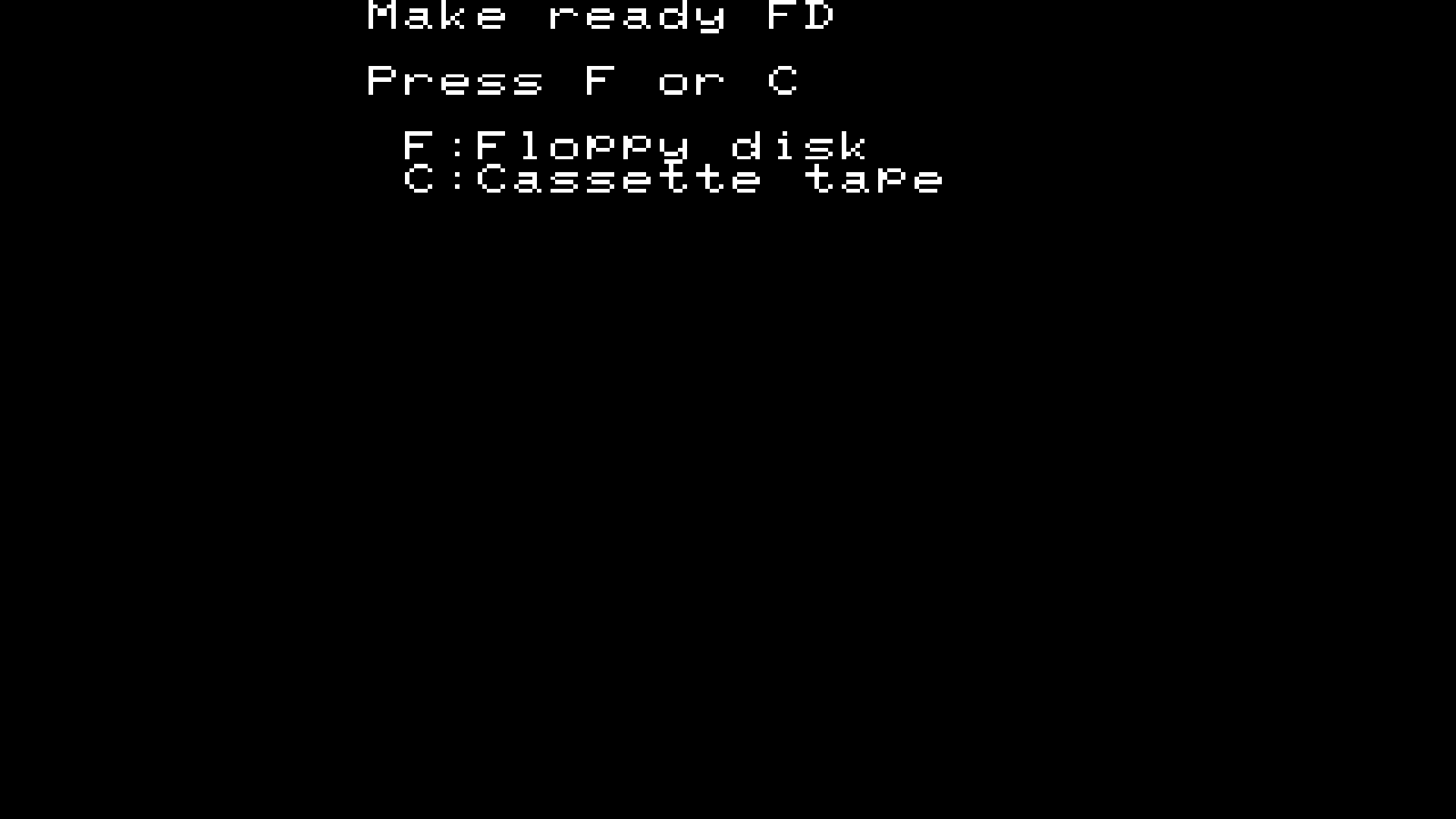

1. Press "C" to load tape
2. Play Tape (MAME Menu -> Tape Controls ->Play
3. You can close he MAME menu and wait until game finishes loading.  Once the game starts, create a savestate within RetroArch

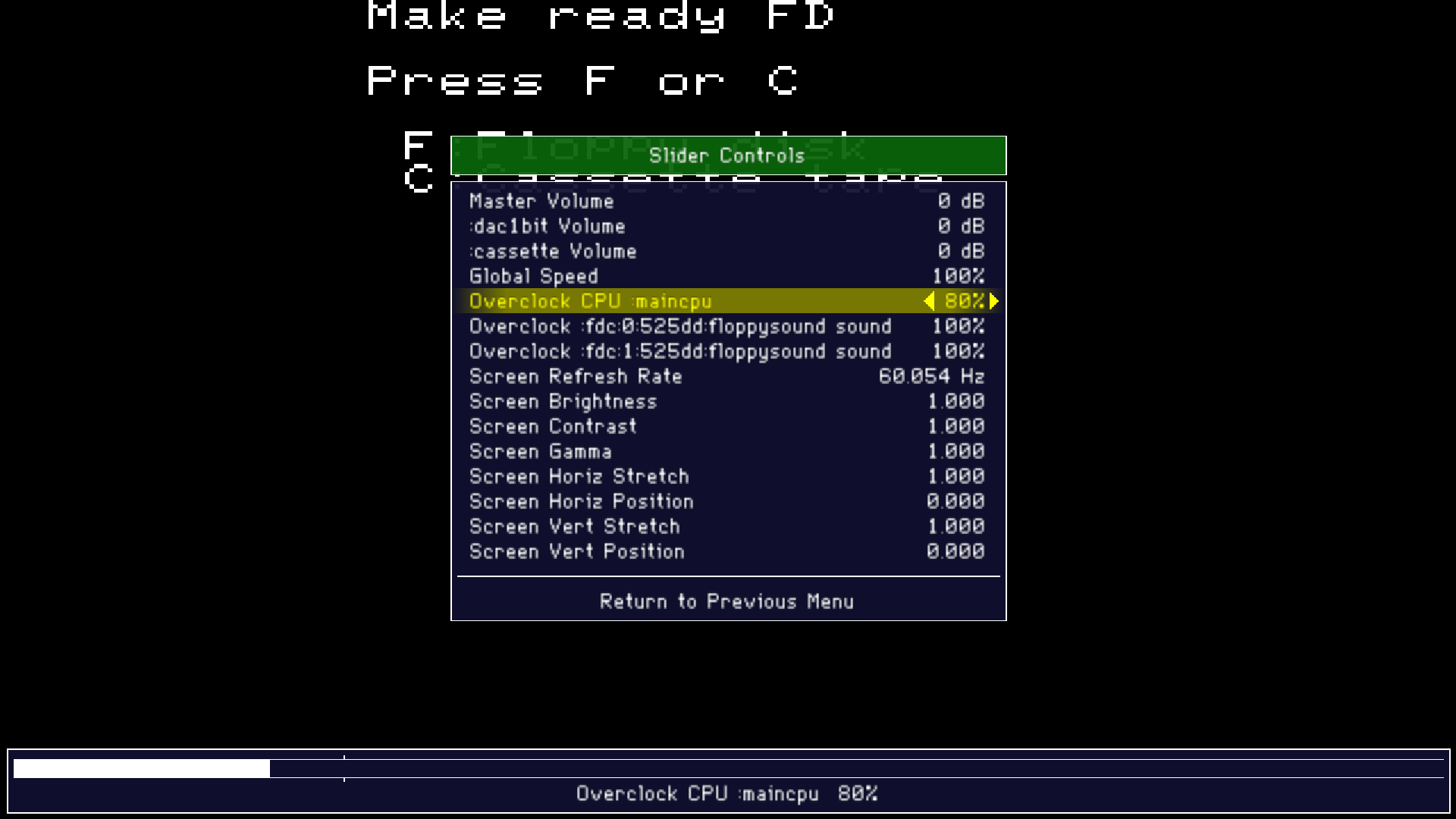

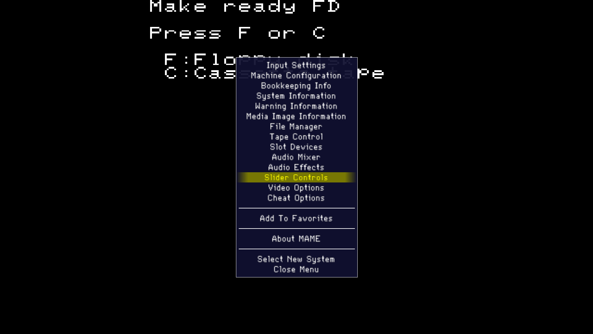

The following games will not work unless CPU speed is adjusted to 80% before loading Cassette
cnonball
hiyokof
mj05
powrfail
sstream
thespidr
vegecrsh
vosque2k
after 80% is selected load cassette using previous steps then create autoload savestate
