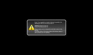

uz1290 Posted July 10, 2015 Author Posted July 10, 2015 Quick update: I made a blank "JoyToKey.ini" file in my directory. Referencing the FAQ section of JoyToKey if an .ini file was not there to begin with it is most likely due to the folder being read only. I checked the properties of the .ini file I made and it is not read only. Don't know if the folder settings take priority over the file within :/. I also get this error message as well but I believe it is still due to the same reason.

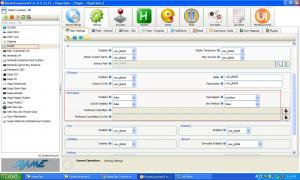

uz1290 Posted July 11, 2015 Author Posted July 11, 2015 I think I may have gotten it! I had to change the setting under my MAME keymapper settings as Dunk3000 referenced above. Thanks for the insight! Will provide picture of my settings briefly.
