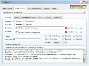

The problem with running it through Hyperspin is that we need to include the system name before the rom in order for UME to recognize the game; however, Hyperspin usually just has the emulator executable followed by the rom. This is where I started playing around with the AHK scripts for MESS and MAME; it was very messy!
Put this into Modules\SNK Neo Geo Pocket
The SNK Neo Geo Pocket Color.ahk code I Frankensteined is:

The code is flexible in that you can substitute the line with "ngpc" for "a5200" for example and
elseIf (systemName = "Atari 5200" && (executable = "ume.exe"))
for the Atari 5200 emulator.
The close process is based on running MAME through Hyperlaunch so that you can keep saved data etc and have a universal exit key.
As I've noted in the AHK script, check your settings.ini file found in the main Settings folder for Hyperspin and make sure that you have the tilde "~" before the ESC key like this:
Exit_Emulator_Key=~Esc

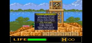

Just like MAME you can hit TAB as the default or if you are running a J-Pac hold down Player 1 button and move your joystick -->.
It will look like this:
The only big difference you will notice is "File Manager"; this allows you access to the operating directory for the file you have currently loaded up. basically if you weren't running the awesome Hyperspin, a person would or could access the other roms/CHDs/cassettes in the directory and switch games this way. As you are running Hyperspin like me, this is something we wouldn't consider but it's nice to know it's there all the same.

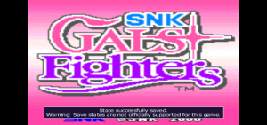

How do I save my games on systems that never supported it?
The default Save State Key is Shift + F7; however, you can change this through the TAB menu explained above to something else on your arcade machine for easier access. When you save, you need to pick essentially a slot for that system, let's use Save State Slot 1 by pushing button "1" on the keyboard or "Player 1 Start" on a J-Pac arcade machine.
The only caveat to this is that if you hit F7 to load the state and are in a different game, it automatically switches games and loads to that state. It's a quick way of switching games if you can remember the load state slot for the games you are playing on that respective system.
If the Save function wasn't part of that system originally or wasn't possible at say the title screen, the UME emulate will still save for you:
TLDR version: In summary, to save push Shift + F7 and to Load push F7. You can change these Hotkeys by using TAB or P1 Start button + --> on J-Pac Machine.

When it is set up properly it will look like this with proper scanlines, resolution and frequency of the original game; not just for arcade machines but for every game of every system I listed above. So the mess games alone are around 69,000 and then 28,000 for MAME. So with the newer systems I think I have over 110,000 games and counting..wow I must be crazy!

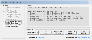

Step 3. Install Soft15khz and run it.
Use my setup as a guide, install just the 15khz even if you have a Trisync monitor like I do.

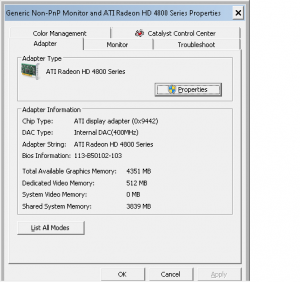

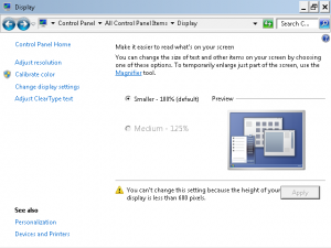

2. Windows 7 64bit Setup Pre-Shelling Procedure

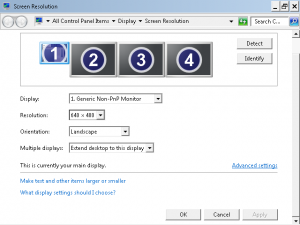

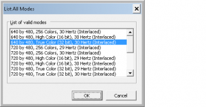

2.a Force Windows 7 into 640 x 480 the desired low resolution mode
The lowest native resolution supported by Microsoft is 800 x 600. To work around this issue, follow these steps from the Display Settings Tab:
0. How do I find my Display Settings Tab (Let's make this guide fool proof so I don't have to repeat myself >.<):
1. In the Display Properties dialog box, click the Settings tab.
2. Click the Advanced Settings button.
3. Click the Adapter tab, and then click the List All Modes button.
4. Select the resolution, color depth, and refresh rate that you want: in this case 640 x 480 @30KHz and click OK.

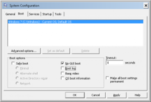

2.B) Remove GUI from boot
To stop the scrolling effect through the load screen due to higher resolution settings than desired, remove the boot gui as follows:
Start Menu -->Search programs and files field-->Type msconfig
Select no-gui in the boot options:
Click Apply button and restart later, there's more to go.

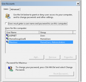

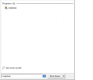

2.c) Setup Automatic Logon to Windows 7 Account
1. Open the Start Menu again, then type netplwiz in the search box, and press Enter like so:
2. Make sure you have a User Account setup, then turn off the password requirements by unchecking the box for "Users must enter a user name and password to use this computer":
3. Fill in the Automatically Log On box that appears with your user name and password, then click OK and you're done.

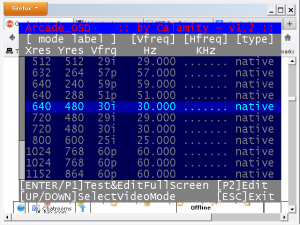

2. e) Run Quickres 2 (To read more from the developer of this fine program, Mark Oetto, simply click his name and select one of his projects from the drop-down tab)
After installing Quickres 2, got to Start Menu -> All Programs -> Quick Res 2: then run the program and select our desired resolution 640 x 480 @ 30Hz from the True Color (24/32 bit) menu.
2. f) Run Soft-15khz (To see more information on the resolutions supported by the program developed by Sailorsat, simply click on the name):
Soft-15KHz adds multiple older resolutions to your graphics card, similar to what ArcadeVGA already comes with preprogrammed.
Only install the 15-KHz option and not the other two available. After this is done, turn off your PC. At this stage if you've been working off a LCD monitor, it is my advice to plug in the VGA cable running from the J-Pac to your PC now. Boot up the PC.
I run dual screens, LCD out of the Secondary video card port and CRT from the Primary one. Until you understand how the resolutions work properly under Windows 7, try loading the operating system with both screens until you find that sweet spot that the CRT monitor accepts.
By default Soft-15KHz will revert to your graphics card DVi-Out and won't function through the VGA if you have both DVi and VGA so bear this in mind when deciding which port to use.
It's dinner time for DrMaxwell and I think you should be set with the above information for now. There is one last step however...

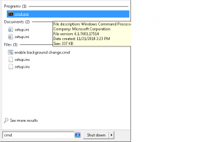

To create a config file go in command:
Then find your UME.exe file by typing for example:
cd C:\Emulation then hit Enter. In the folder holding UME, type UME.exe -cc then hit Enter.

Thanks again for all your help. Are you positively sure you got the 9.3_1.2a driver installed under windows 7? I had that exact driver working perfectly on winxp 64 on the same machine. I've tried every trick I know of to make windows 7 install that 9.3.1.2a radeon driver but it simply won't take it since its not for windows 7. Can you show a picture of your driver version on your 7 machine?
Thanks for all you explanation and write-up, but unfortunately, I am with OPCode here - how did you get the "crt_emudriver_9.3_1.2a_x64_multisync.rar" to install under windows 7? Would you mind providing the step-by-step for that first part please?
I think you've missed the point guys. To get the end result of running Windows 7 64 bit at lower resolutions and refresh rates that sync with the information provided on the nag screen for UME, you just need to have a compatible graphics card on the list, Soft-15KHz installed and Quick Res 2. The lower end drivers will open up the possibilty of of some of the resolutions and frequencies you'll need but really, Soft-15KHz provides the rest. It's like an ArcadeVGA card that comes preloaded with this information, all we are really doing here is loading custom lower end resolutions into the card through a software based solution.
My Soft-15KHz driver page reads:

Thanks for replying DrMaxwell!
I guess the issue both opcode and I have is that for the life of us - Soft-15Khz does NOT show up in Windows 7 (all greyed out) - and I am trying to get it to work, with whatever driver (hacked or not) might work.....
PS. I am running Windows 7-64 and have the HD4890 card.
http://i.imgur.com/mCYX9Qr.png

Those are the drivers I'm using in Windows 7 to achieve the end result. Does this help you out?
