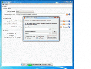

suspct Posted August 15, 2015 Posted August 15, 2015 Hi All, Very new to these forums and have found the info on here great!! Im almost finished my build but i have stumbled across a wierd issue when trying to generate the mamelist.xml in Hyperlist, it opens up rocketlauncher. !!! any help would be greatly appreciated thanks in advance..
griffin518 Posted August 16, 2015 Posted August 16, 2015 Try putting in a destination DB (ie output XML) and re-running. Let us know if the error pops up again. Download my RocketLauncher bezels: http://hyperspin-fe.com/files/file/14367-griffin518s-bezel-depot/ Best of MAME HyperSpin XML: http://www.hyperspin-fe.com/files/file/11710-griffin518s-best-of-mame-xml-database/ Best of MAME bezel pack: http://www.hyperspin-fe.com/files/file/11711-griffin518s-best-of-mame-bezel-pack/ Custom MAME ini files w/HLSL settings: http://www.hyperspin-fe.com/files/file/11712-griffin518s-best-of-mame-mameuifx-ini-files/
suspct Posted August 16, 2015 Author Posted August 16, 2015 thanks for the suggestion, but same thing it still just opens rocket launcher for some reason.
suspct Posted August 16, 2015 Author Posted August 16, 2015 Figured it out finally, the issue was Mame in HyperHQ was set to launch through rocketlauncher... changed it back to Hyperlaunch and selected the Mame64 Emulator and off it went. Thanks
