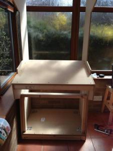

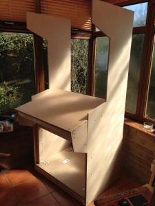

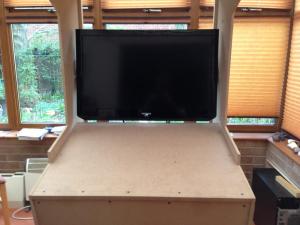

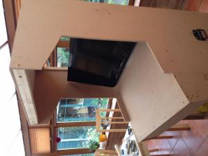

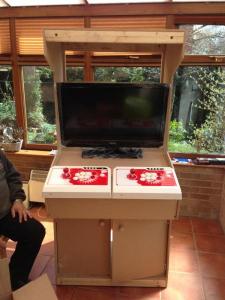

Hello Hello, first post and everything but I gotta say this forum has been a godsend whilst building this cab and hyperspin is just perfect as a front end system, if I'd have know it existed I might have built one years ago.
Anyway, here's a few snaps of my cab with a little (LOTS) of help from my old boy we're probably about half done
Will end up covered in white vinyl (brother in-law conveniently is a manager at a local sign company) with capcom decals, streetfighter most likely.
I think it's shaping up nicely, two Qanba fightsticks for controls, I had intended to put an Ipac board in and wire all the sticks and buttons in myself but i thought these looked the business and the company I bought them from hooked me up with octagonal gates anyway.
Any hints or tips welcome!
