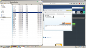

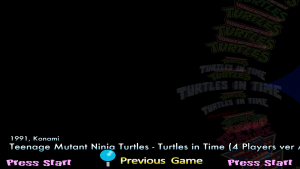

cudencuden Posted September 2, 2015 Author Posted September 2, 2015 yes..i downloaded emu's 240p mame pack. configured path to videos as screenshot shown. even put videos in default path....converting to flv...disabled flash hardware acceleration...all yields same result as justBlank.png yes, i am hyperSpin v1.4
Metalzoic Posted September 2, 2015 Posted September 2, 2015 It looks like you're entire theme is blank. Is that the case, because you didn't even mention that. If your themes can't load there's no way for them to play your vids. That looks like your real issue. Did you move those for some reason too?
cudencuden Posted September 2, 2015 Author Posted September 2, 2015 It looks like you're entire theme is blank. Is that the case, because you didn't even mention that. If your themes can't load there's no way for them to play your vids. That looks like your real issue. Did you move those for some reason too? you are correct. haha..now i feel dumb...downloaded theme, overwrote some files. everything is working. thanks. i moved files because c is not big enough for me..i put all my roms and Media folder of hyperspin on bigger usb drive
Metalzoic Posted September 2, 2015 Posted September 2, 2015 Awesome. Glad you posted a picture so I could notice and glad you got it working! Believe me I've had plenty of times where nothing seemed to work right and it was me either overlooking something simple. How does it seem to run from a USB drive? As smooth as an internal? Less smooth, but still smooth? Just OK? Poopy? I'm curious.
