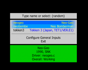

Sheep190 Posted September 1, 2015 Posted September 1, 2015 Hello everybody, So far I've setup Hyperspin and Rocketlauncher and it went quite well The only problem I have now is that when I launch a game trough one of those mentioned it starts the MAME emulator and then I get the rom selection screen instead of launching the game I selected. I have enclosed a screenshot. Thanks for your help!
yatsey Posted September 1, 2015 Posted September 1, 2015 open rocketlauncher mame settings then go to skip checks and try the different settings. i had to change mine to rom extension to get my arcade classics to work.
Sheep190 Posted September 1, 2015 Author Posted September 1, 2015 open rocketlauncher mame settings then go to skip checks and try the different settings. i had to change mine to rom extension to get my arcade classics to work. Thx! Changed the Skip Checks to rom extension and then it worked!
