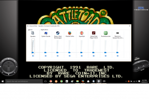

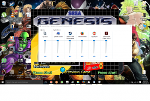

jrock1000 Posted September 10, 2015 Author Posted September 10, 2015 On 9/8/2015 at 4:08 PM, SIMPLYAUSTIN said: check the volume mixer ion windows WHEN RETROARCH IS RUNNING to ensure the volume is set to normal with windows. then the only option could be inside the RetroArch settings. Go to sound settings and make sure you have it turned on or at least up? thanks austin iv done this and will put up photos the first one shows full volume for everything while running hyperspin. then the second photo shows how it instantly changes once it launches with retroarch. tonight i have even tried to remove retroarch and reinstall it and still have the same issue
SIMPLYAUSTIN Posted September 10, 2015 Posted September 10, 2015 hmmmmm... that is a strange one. at least we now know its the volume in windows thats triggering it. This only happens when you load a system using RetroArch then? Simply Austin's YouTube
