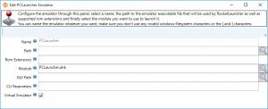

Another weird one was seeing "PCLauncher.exe" what is that? PCLauncher is a module (an AHK file) it should not be an exe.
Globally PCLauncher should be set up like this.
Indeed, module was pointing at wrong thing, just couldn't see it skimming through settings.
I knew it was something simple, I'd just gone blind to it, thanks a lot for your time Mr.Gigapig.  :)
