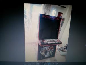

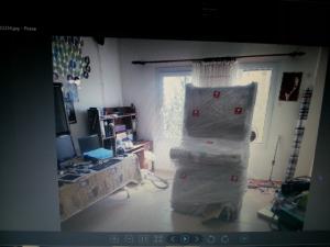

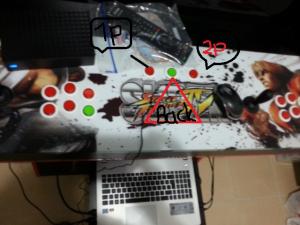

hanzoo Posted September 24, 2015 Posted September 24, 2015 Hello, I am Gorkem from Turkey, I like this Hyperspin forum,lots of people are smart and they know what they are doing, I been stuck with the controller setup,i been trying for a long time,i would love to thanks to people who tried to help me alot ,(madhatter3339-dragon57-32assassin) In my country no one knows about hyperspin,no onewas able to help me, I did order my arcade cabin from Istanbul,it came with old pc (pentium 4) and maximus arcade ,most games didnt work,so what i wanna do is I would love to use my Asus i7 n56vz laptop,4gb graphic card and 12gb ram,i think it will handle, I did watch lots of youtube videos (thank you AUSTIN) but i am still having problems,I tought i got set up my controllers,but when i play 2 players street fighter game ,1st player with ken when i hit the 5th button on the second player Ryu moves ,seems like i made somewhere mistake, By the way i asked the people where i got my arcade cabin about what type of controllers i have,they told me i have hack joystick,the way i saw all the cables tied and have usb at the end ,they didnt use ipac or other things, I posted pictures i would love to setup my controllers like the same way,please i need help ,will it work if someone can send me save joystick setup file, what should i do? And hyperlaunch menu at the bottom i get those errors ,i have no clue , Please people ,you have the best knowledge ever ,i just need some help, all of you done is a good job making cabins,you guys are all good ,congratulations,if you please can give me some ideas i would be appreciated, Thank you so much Regards Gorkem

hanzoo Posted September 27, 2015 Author Posted September 27, 2015 I was so happy the controllers work for the arcade cabinet, But i don't know when i start back the pc the controllers dont work again ,but i saved everything , There is some mistake,or i forgot to do something , Problems i am having : everytime i start hyperspin it says 'joytokey ver 5.7.1. (not registered):profile 1 (the screen pops up) is it maybe because it is not registered When i play the Nintendo -family computer disk system it gives me (d3dx9_41.dll) do i have to download the dll files put it in the c : drive where do i put them exactly Nintendo Wii gives me -xinput1_3.dll And when i played Nintendo64 the screen is so tiny how do i make screen size bigger Thank you
