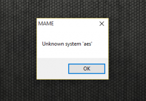

funkychimp Posted October 10, 2015 Posted October 10, 2015 Hi all, I am trying to run NeoGeo AES via MAME but on launch I get the attached error. Has anyone seen this before? Any help would be most appreciated. Kind regards funkychimp
pinsanity Posted October 10, 2015 Posted October 10, 2015 Rename the system to "SNK Neo Geo AES" with a space between Neo and Geo
funkychimp Posted October 10, 2015 Author Posted October 10, 2015 Hi pinsanity, Thanks for the quick response. Yea it is named like that already in RL - 'SNK Neo Geo AES'. I know this is correct as the little icon appeared next to its name within RL when I added it. My 'SNK NEO GEO MVS' system loads up just fine. Regards funkychimp
funkychimp Posted October 10, 2015 Author Posted October 10, 2015 Hi, I think I have just found the problem. I am using 'MAMEUIFX 0.160 x64 NoNag+HiScore+noBuffer+DirectInput.exe' as my MAME build. When I download the standard version of MAME and use that it works just fine. Regards Paul
