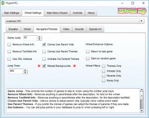

gigapig Posted October 11, 2015 Posted October 11, 2015 In HyperHQ try checking Reload backgrounds for every system you set up. That means if a game has no theme the default will be loaded so the video will play.
swaakx Posted October 11, 2015 Author Posted October 11, 2015 Excellent, this last tips worked ! Thanks a lot !
