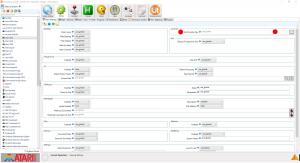

geekygreek7 Posted December 8, 2015 Author Posted December 8, 2015 I believe I'm up to date, but changing the RocketLauncher "Exit Emulator" key doesn't do anything for the emulator. Not sure why. I'm also not sure why I have to set up where the emulator's EXE file is in HyperHQ either as it takes precedence over RocketLauncher.
geekygreek7 Posted December 8, 2015 Author Posted December 8, 2015 On 12/8/2015 at 12:45 AM, agent47 said: You don't have to set the emulator's exe in HyperHQ. If you have that set and the Execution set to Normal instead of HyperLaunch that could be your issue. I always have the execution set to hyperspin on everything, but it still won't run unless i set the exe in HyperHQ. Can't figure out why. On 12/8/2015 at 12:53 AM, gigapig said: What emulator are you referring too? I'm hoping for all my emulators to exit with my arcades EXIT button which is set to altF4. (some emulators don't exit unless you do this, so I've just set my arcade exit button to a universal exit command of altF4). The problem is, I don't want someone to hit Exit again on accident lets say, and have it exit hyperspin too and bring them to the desktop.
