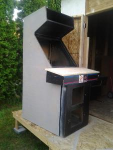

twz2004 Posted June 20, 2013 Posted June 20, 2013 Hey folks, I'm starting a new project and developing my first MAME arcade machine. The cabinet I've selected to work with is a Williams NBA Jam cab. I do have some questions for folks who have developed their own MAME machines. What is the best choice for a video card? I want to run games like Pac-man to more power hungry games such as Gauntlet Legends, or Mortal Kombat and modern games. I'm debating between building my own PC to power this cab.
RidicRick Posted June 21, 2013 Posted June 21, 2013 Just a suggestion to make the cab thinner, my buddy hacked off dam near a foot from the back.. then cut the cab in half and put new middle pieces in to make it wider. Has a 32" LED in it. Here is the link to the thread.. http://www.hyperspin-fe.com/forum/showthread.php?25338-Completed-some-hyperspin-cabs-check-them-out
