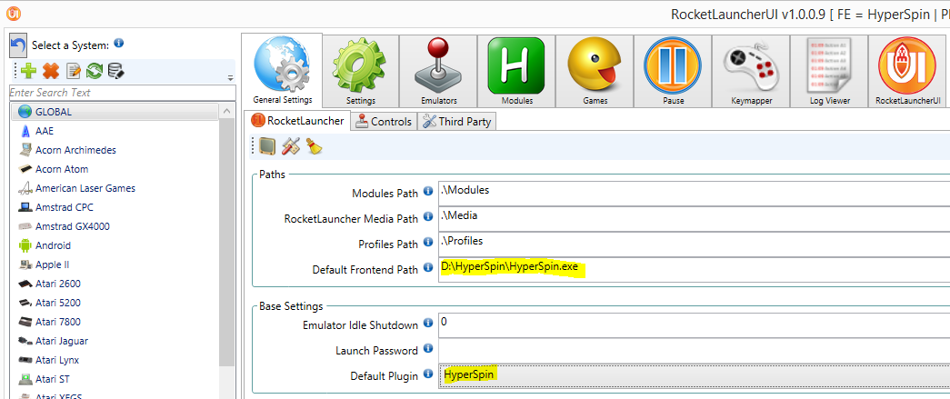

teaseapea Posted January 26, 2016 Posted January 26, 2016 Hi all. I've recently been getting into HyperSpin thanks in no small part to Simply Austin's vids on YouTube. Thus far, everything is going pretty much to plan but I have noticed one strange anomaly - if I run a game from the "Audit Games" part of RLUI, the fade screen shows all the info I requested (game title, year, publisher, rating). However, if I do this from the main HS frontend, the publisher name does not show up. I read on this forum that the decision had been taken to split the "Manufacturer" field into "Developer" and "Publisher", so I assume this is causing the problem? The databases I am using are from this site, but I notice they still use the old "Manufacturer" field. Any assistance on this would be very welcome.

NewYears1978 Posted January 26, 2016 Posted January 26, 2016 Which system is this? MAME? Can you look at your database in HyperSpin/Databases/YourSytemname/YourSystemname.xml open the file and see if your games have <manufacturer>Atari</manufacturer> section for each game? Also, this isn't directly related but can cause info not to show up, make sure you've set these: Are you an HTPC user? Do you like Kodi/XBMC?If so, check out these Kodi Style Themes!-----------------------------------------------------------------------------------------------------Aeon Nox 13 by @dark13Aeon MQ6 by @NewYears1978 >> Click here to see Current Progress-----------------------------------------------------------------------------------------------------If you're new and going for your first install, I HIGHLY recommend Simply Austin's Tutorials.
teaseapea Posted January 26, 2016 Author Posted January 26, 2016 Ahh, that was the problem - the frontend wasn't set correctly. I *had* set HS as the active and default frontend in the RLUI tab, but not in General Settings. Just checked it out and now the correct info all shows. Many thanks, that was really starting to annoy me!
