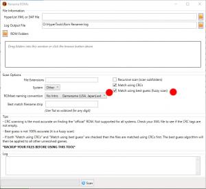

superbike2 Posted February 9, 2016 Posted February 9, 2016 Hey Guys, I'm relatively new to HS and I've been trying to add a couple of new systems. I've got an XML list for Nintendo DS and i'm trying to rename the roms so that they work, However, when i'm using dons rom renamer and i've set all the parameters and click scan i get a message saying "It appears that this XML file does not have CRC tags for your games. Either this system is not currently supported or your XML file is out of date" I've searched online but to no avail. Anyone have any idea what the problem is? The XML file I have was grabbed from Hyperlist on here and I've even tried to create one with list generator but it's still not working. any advice received gratefully!!
gigapig Posted February 9, 2016 Posted February 9, 2016 If there is no crc in the xml you will have to uncheck that option in Hypertools and use fuzzy match instead. You can also give Turmatcher a try.
superbike2 Posted February 9, 2016 Author Posted February 9, 2016 Might be cos i'm looking in the wrong place but i can't find Turmatcher.... or the option for fuzzy match!
gigapig Posted February 9, 2016 Posted February 9, 2016 http://www.hyperspin-fe.com/files/file/5603-tur-matcher/
