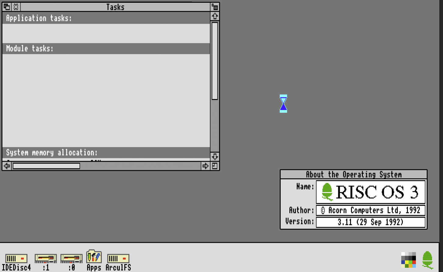

vaderag Posted March 17, 2016 Author Posted March 17, 2016 As promised, here is a lovely fade attached (preview below - the task pane has the game details in it... Hourglass animates with Loading underneath... (it's 16:10 but you could edit it as required) Paste the following into your Settings -> Acorn Archimedes -> RocketLauncher.ini in place of the [Fade] section [Fade] Fade_In=true Fade_In_Duration=500 Fade_In_Transition_Animation=DefaultAnimateFadeIn Fade_In_Delay=1000 Fade_In_Exit_Delay=2500 Fade_Out=false Fade_Out_Extra_Screen=false Fade_Out_Duration=500 Fade_Out_Transition_Animation=DefaultAnimateFadeOut Fade_Out_Delay=500 Fade_Out_Exit_Delay=0 Fade_Layer_Interpolation=7 Fade_Mute_Emulator=false Fade_Use_Backgrounds=false Fade_Base_Resolution_Width=1920 Fade_Base_Resolution_Height=1200 Fade_Layer_1_Color=FF000000 Fade_Layer_1_Align_Image=Stretch and Lose Aspect Fade_Layer_2_Alignment=Stretch and Lose Aspect Fade_Layer_2_X=0 Fade_Layer_2_Y=0 Fade_Layer_2_Adjust=1 Fade_Layer_2_Padding=0 Fade_Layer_2_Prefix=Layer 1 Fade_Layer_3_Alignment=No Alignment Fade_Layer_3_X=1190 Fade_Layer_3_Y=510 Fade_Layer_3_Adjust=1 Fade_Layer_3_Padding= Fade_Layer_3_Speed=3200 Fade_Layer_3_Animation=DefaultFadeAnimation Fade_Layer_3_7z_Animation=DefaultFadeAnimation Fade_Layer_3_Image_Follow_7z_Progress=false Fade_Layer_3_Type=image Fade_Layer_3_Repeat=4 Fade_Layer_3_Shadow_Image_Transparency=30 Fade_Layer_3_Static_Alignment=No Alignment Fade_Layer_3_Static_X=1185 Fade_Layer_3_Static_Y=506 Fade_Layer_3_Static_Adjust=1 Fade_Layer_3_Static_Padding=0 Fade_Layer_3_Static_Prefix=Infobar Fade_Layer_4_Pos=No Alignment Fade_Layer_4_X=1225 Fade_Layer_4_Y=420 Fade_Layer_4_Adjust=1 Fade_Layer_4_Padding=0 Fade_Layer_4_FPS=400 Fade_Animated_Gif_Transparent_Color=FFFFFF Fade_Bar_Window=GDI Fade_Bar_Window_X= Fade_Bar_Window_Y= Fade_Bar_Window_Width=900 Fade_Bar_Window_Height= Fade_Bar_Window_Radius=30 Fade_Bar_Window_Margin=30 Fade_Bar_Window_Hatch_Style=8 Fade_Bar=true Fade_Bar_Non7z_Progress_Time=0 Fade_Bar_Back=true Fade_Bar_Back_Color=FF555555 Fade_Bar_Height=30 Fade_Bar_Radius=10 Fade_Bar_Color=DD00BFFF Fade_Bar_Hatch_Style=8 Fade_Bar_Percentage_Text=true Fade_Bar_Info_Text=true Fade_Bar_X_Offset=0 Fade_Bar_Y_Offset=150 Fade_Rom_Info_Description=filtered text Fade_Rom_Info_System_Name=disabled Fade_Rom_Info_Year=text with label Fade_Rom_Info_Developer=disabled Fade_Rom_Info_Publisher=disabled Fade_Rom_Info_Genre=disabled Fade_Rom_Info_Rating=disabled Fade_Rom_Info_Order=Description|SystemName|Year|Manufacturer|Genre|Rating Fade_Rom_Info_Text_Placement=User Defined Fade_Rom_Info_Text_Margin=7 Fade_Rom_Info_Text_1_Options=w1600|787 h90 x35 y110 cFF000000 r4 s70 Left Regular Fade_Rom_Info_Text_2_Options=w400 x53 y57 cFF555555 r4 s60 Bold Fade_Rom_Info_Text_3_Options=w310 x207 y960|1665 cFFE1E1E1 r4 s66 Left Regular Fade_Rom_Info_Text_4_Options=w1305|492 h66 x460 y960|1665 cFFE1E1E1 r4 s66 Left Regular Fade_Rom_Info_Text_5_Options=x57 y120 cFF555555 r4 s42 Bold Fade_Rom_Info_Text_6_Options=h135 x57 y885|1590 cFFCFCFCA r4 s120 Regular Fade_Rom_Info_Text_7_Options=use_global Fade_Stats_Number_of_Times_Played=text with label Fade_Stats_Last_Time_Played=text with label Fade_Stats_Average_Time_Played=text with label Fade_Stats_Total_Time_Played=text with label Fade_Stats_System_Total_Played_Time=text with label Fade_Stats_Total_Global_Played_Time=text with label Fade_Stats_Info_Order=Number_of_Times_Played|Last_Time_Played|Average_Time_Played|Total_Time_Played|System_Total_Played_Time|Total_Global_Played_Time Fade_Stats_Info_Text_Placement=User Defined Fade_Stats_Info_Text_Margin=57 Fade_Stats_Info_Text_1_Options=x35 y260 cFF000000 r4 s28 Bold Fade_Stats_Info_Text_2_Options=x35 y300 cFF000000 r4 s28 Bold Fade_Stats_Info_Text_3_Options=x35 y340 cFF000000 r4 s28 Bold Fade_Stats_Info_Text_4_Options=x35 y380 cFF000000 r4 s28 Bold Fade_Stats_Info_Text_5_Options=x35 y420 cFF000000 r4 s28 Bold Fade_Stats_Info_Text_6_Options=x35 y460 cFF000000 r4 s28 Bold Fade_Text_1_X=0 Fade_Text_1_Y=0 Fade_Text_1_Options=cFFB4B4B4 r4 s30 Right Bold Fade_Text_1=Extracting Game Fade_Text_2_X=0 Fade_Text_2_Y=0 Fade_Text_2_Options=cFFB4B4B4 r4 s30 Right Bold Fade_Text_2=Extraction Complete, Ready Fade_Text_3=Loading Game Fade_Text_4=Loading Complete Fade_Font=Consolas Fade_System_And_Rom_Layers_Only=false Fade_Extraction_Time=disabled Fade_Extraction_Time_Text_X=0 Fade_Extraction_Time_Text_Y=0 Fade_Extraction_Time_Text_Options=cFF555555 r4 s20 Bold Fade_Layer_2_W= Fade_Layer_2_H= Fade_Layer_3_W= Fade_Layer_3_H= Fade_Layer_3_Static_W= Fade_Layer_3_Static_H= Fade_Layer_4_W=use_global Fade_Layer_4_H=use_global Fade_Click_Through=use_global Fade_Click_Through =use_global Fade_Rom_Info_Manufacturer=text with label Edit... Darn - not allowed to upload as too big... PM me if you want it unless a mod can let me upload... it's 289kb
