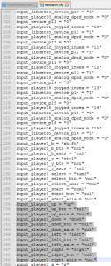

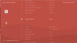

kylecp1979 Posted March 27, 2016 Posted March 27, 2016 Retroarch for some reason reads the arrow keys as number pad directions num8,num2,num4 and num6 so You have to go into the retroarch config file and manually change them to up,down,left,right. Also when I was setting up an ipac for my relative the hotkey would conflict with the games so go to the hotkeys and enable a button. If you want to use your hotkeys you have to hold that button you assigned down then hit your hotkey
ArcadePC Posted March 28, 2016 Author Posted March 28, 2016 thank you for your reply. i changed the num. pad keys to the arrow keys in retroarch.cfg and went back to retroarch, remapped all the nessesary buttons for snes (not the d-pad keys) and put a menu toggle button. then i saved the configuration (alltough i do have "save config on exit on") and i saved it for the core bsnes balanced. then i ran super mario all stars + super mario world, and the arrow keys worked fine and the start button (enter on the i-pac) but none of the other button worked, not even the menu toggle btn. so what do i have to do more, or what did i do wrong? please reply fast (again) and i should see the message until 9pm. tank you in advance.
