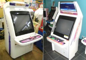

Thanks a lot! That's a bunch of infos I'll be in need of that you just gave me. Now I feel even more into my "squaring a circle" problem. I have already got all my stuff prepared for Win7 64 and these comments rise some interesting issues. About the monitor, you said "Assuming the monitor is a standard Arcade resolution monitor" , I'll be more clear , it's not an arcade monitor, and it's not a PC Monitor ! (would be too easy..) it's a .. television. I asked about the model, he said he didn't know, of course, boxes and manuals are long gone.. It's a Philips 32'' CRT television,
Here is the beast by the way, he just sent me pics:
(notice that he switched the original basic blue artwork on top for KOF2002 one ^^..anyway it's not a collector thing since PCB/Monitor were missing)
