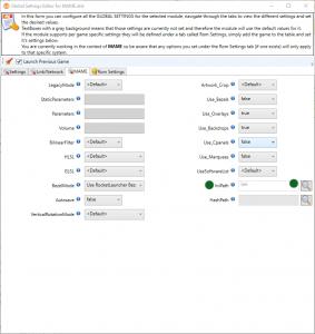

gigapig Posted April 7, 2016 Posted April 7, 2016 Did you also set the ini path in RLUI under the module settings, mame tab? Where is your mame.ini and is it the only one you have? If you have more then you also need to make changes to the others as well, e.g vertical.ini, horizont.ini and vector.ini
gigapig Posted April 7, 2016 Posted April 7, 2016 Where do I set the ini path in RLUI? Here. It may already be set but that will depend how you set it up.
