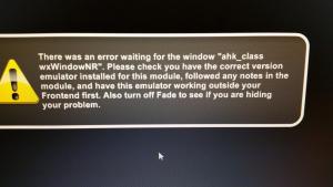

chexmix222 Posted April 12, 2016 Author Posted April 12, 2016 Well I did it, I'm now on HS 1.4 and got dreamcast to work! But when the game runs say crazy taxi I push buttons on my controller and I can still hear HS running as if I'm selecting menus in HS, if that makes any sense idk if I'm explaining it right, also when I start dreamcast it runs but shows my desktop I have to click on the emu at the bottom to play it don't know if that has anything to do with it Also my Playstation 2 emu gives my this error (in pic) but it still plays in the background, I just click on it and I can play it I'm running PCSX2 1.2.1
Spawk Posted April 12, 2016 Posted April 12, 2016 Good job chexmix! I am using pcsx2 1.4.0 without any issue. Try that version. For the DC issue (using nullDC?), the module was tested with the r141 version. I just checked mine and I'm running "nullDC_Win32_Release-NoTrace". I don't remember why I started using this special build, but everything is working good so far so I haven't updated. Maybe related... How are you controlling HS? If you are using the joystick option in hyperHQ, it is buggy and should probably be turned off. There are better ways to handle controls. I have definitely heard of this controlling HS in the background thing. Should NOT be happening.
