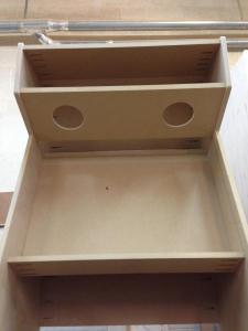

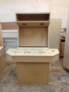

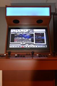

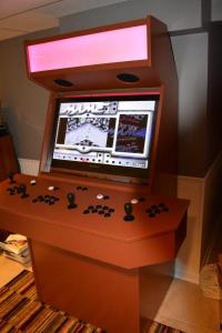

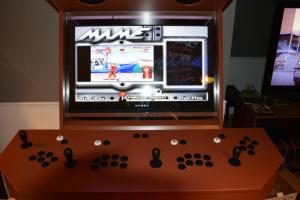

Hey all. Just thought I'd share my first build that my friend and i made together. We wanted a clean panel with enough room for 4 guys to be comfortable, which is why you won't see anything but sticks and buttons. However, we designed it in a way that can easily be swapped out with other panels if you choose to. I plan on making another 2 player panel with a trackball, flight stick, and possibly a steering wheel. Might get a couple of guns, but that's for later.

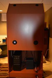

It's made out of paint grade MDF with a industrial conversion varnish topcoat (much more durable than paint). It can be completely broken down and moved with ease so it can actually fit through a doorway. I still have to install volume control, artwork, main power button, and fan grates.
Let me know what you think!

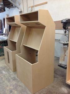

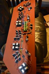

Looks like you built one each for the both of you? Very clean wiring job! It looks good, and no franken-panel with too many extra buttons! I just wish I had enough friends that cared to play to justify a 4 player build myself.
Yeah, my buddy is a cabinetmaker who owns his own shop, so it was very convenient for us to each build one there. I'm an electrician by trade and I used to be a cabinetmaker too. As far as the panel goes, I'm actually not very happy with it. I used the kit from ultimarc, but if I could do it again, I'd get my own wire and make it even cleaner. Practice makes perfect I guess. The reason I wanted a 4 player cab is specifically because I do have enough friends that enjoy gaming as much as I do. Haven't had anyone over to play it yet, but i know it will happen often.
