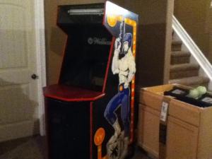

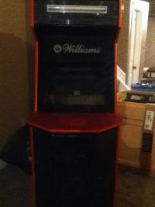

mitchell8134 Posted September 21, 2013 Posted September 21, 2013 Been working on Programing forever it seems like, but finally getting ready to build my first cab. Was planning on building the entire thing until I came across this on Kijiji in my area for $50. Someone has already torn it apart but still has monitor glass, marquee glass, speakers, coin doors and seems to be very solid. Also has brand new T molding on entire cab. Control panel is rough so probably going to build a new one from scratch. Was planing on putting a flat screen in for monitor but wanted some feedback on if i should change the angle that should mount it. I see on many others that have used flat screens they have them mounted almost vertical or just a bit angled where mine is probably a little more than 45 degrees. I know that if I change it it will be a bit of work and will have to re arrange speakers but would rather do it now than later. Let me know what you think. Sorry pics are crap quality
MontyQ Posted September 21, 2013 Posted September 21, 2013 looks good...the art is the game smash t.v. right ? I'd leave the monitor angled, all depends on what you like but for me I like looking downward instead of straight in front of me. But it's all about where you feel best looking as you play.
mitchell8134 Posted September 21, 2013 Author Posted September 21, 2013 Ya it is smash T.V. there seemed to be a few different cabs for this game but i like how this one has the speakers above the screen hiding by the Williams grate
