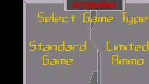

Now I made the Hyperlaunch HQ Settings and when I launch now a game in Fullscreen the picture jumps to the right side. Its not in the middle...And not completly on the screen. My Windows has 1920x1080 resolution on a TV with a Gigabyte Brix Pro and HDMI. I tried to edit the hyperlaunch emu Settings but every fullscreen resolution the picture is not ok. Should i go back to launch them without Hyperlaunch? I also had the same problem when I used your command line without Hyperlaunch...

Hello and welcome to the Forums!
Please post your HyperLaunch log and your Daphne log using code tags as described here:
http://www.hyperspin-fe.com/forum/showthread.php?31072-The-HyperNoobie-Guide-For-Posting-To-The-Fourm
A screen shot would be helpful here as well.
One thing, you did not rename your framefile. It should probably be named 38AmbushAlley.txt like the singe file. It might not make a difference at all, but for standard naming, it would probably be best.
You could go back to launching with the bat file, but you will miss out on all the cool HyperLaunch stuff: Fade, Bezels, Statistics & HyperPause.
I look forward to seeing your logs.

Screenshots of the problem:
and the Log:

Yes I renamed the Files like you told in the first post on your topic.
Thanks that you check the log Files and want to help...
The same happens if I boot with the .bat file and have the option -fullscreen_window instead of -fullscreen
So I think the error is at Hyperlaunch HQ starting Line at 22:24:29:588 | MD | DEBUG1 | +31 in the log file...
It is the -fullscreen_window but how is this changeable? So that Hyperlaunch HQ launches with -fullscreen?
Here is the Daphne Log:
and the Log:
Cyber,
Try setting your emulator screens size to a 4x3 aspect ratio. Something like 1024x768 and let me know how that works for you.
Thanks,
Ron
Cyber,
Thanks,
Ron[/quote?
Hi
Do you mean the settings in Hyperlauch when I click on Emulator... There I have 1024x768 already...
I think the start option is the problem for me: -fullscreen_window
When I disable the Fullscreen Button in Hyperlaunch HQ then its ok but only in a Window...
Or do you mean in Daphne somewhere? Never worked with Daphne before... A Setup or Setttings File?
Thanks
Cyber,
Thanks,
Ron
Hi
Thanks
Sorry it took so long to reply.
I have no idea why the emulator screen is not centered. I cannot reproduce the issue you are having. Is it possible that you have more than one monitor/screen connected that's causing the issue? Or that the TV is not switching resolutions correctly?
About the -fullscreen_window, it should be almost the same as the -fullscreen setting. The biggest difference is that with the -fullscreen_window setting, this allows your light gun to work correctly. Many will not work with just the -fullscreen setting. The cursor gets stuck along the sides of the screen. But, to test, you can make one change in the module to see.
Navigate to .../HyperSpin/HyperLaunch/Modules/Daphne Singe and open the file Daphne Singe.ahk in your favorite text editor.
NOTE: It is never advisable to edit the modules directly, so make a backup of the file and restore it when you are done.
Find the line (around line 60):
fullscreen := (If Fullscreen = "true" ? ("-fullscreen_window") : ("")) ; fullscreen_window mode allows guncon and aimtraks to work
And change it to look like this:
fullscreen := (If Fullscreen = "true" ? ("-fullscreen") : ("")) ; fullscreen_window mode allows guncon and aimtraks to work
Save the file and test.
Please let me know the results.
Thanks,
Ron
Thank you! Thats it... Now its fullscreen but I don`t have a Lightgun so its ok for me... :)
Maybe its my TV (Samsung 50") or its caused by the Intel Iris Pro Graphics of my Gigabyte Brix I7 or... But so its working :)
Thank you! Thats it... Now its fullscreen but I do`t have a Lightgun so its ok for me... :)
Cool. Glad it's all sorted out!
Thanks,
Ron
