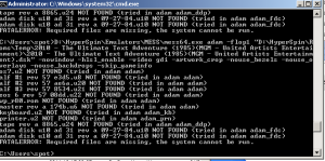

spotUP Posted December 20, 2014 Posted December 20, 2014 What is going on here? I have the required adam bios files in roms/ where i keep all my other bioses and they seem to have the correct names.. "adam adam" looks strange to me?..
spotUP Posted December 22, 2014 Posted December 22, 2014 somehow... starting mess.exe with adam as argument from the commandline fixed this. i've now got mess running adam games. anyone got a nice db?
