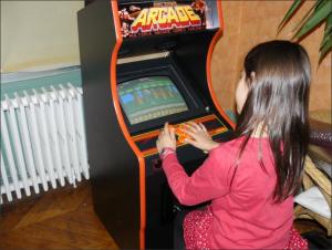

EvilDindon Posted November 7, 2013 Posted November 7, 2013 Hi, It's been a while I did'nt used Hyperspin, but now a made my own mini cab, (see this topic, in french ), and installed HS 1.3 on it, I noticed that browing the wheel with a joystick is laggy and not precise at all. For example, it offens jump 2 or 3 games at a time. Is it a known HS bug ? Are there solutions for it ? Cheers, Mike. My daughter playing on the cab : "Dindon" means "Turkey" in french.
gigapig Posted November 7, 2013 Posted November 7, 2013 Bonjour Evil Turkey Have you got Spinner or Trackball switched on in HyperHQ? Gamepad support is broken so if your controls were linked to a gamepad then you would need to use a keymapper. But you are probably using an I-pac or something so check HyperHQ first. Great picture by the way.
