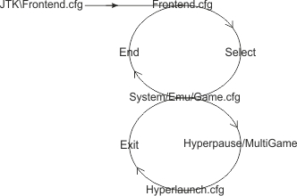

Faahrev Posted January 2, 2014 Posted January 2, 2014 First off, it's always a good idea to keep your configuration up-to-date. A lot of stuff only works (correct) when using the latest versions of HL and all supporting modules and libraries. Second, I don't understand why you are using an old version of JTK. What exactly doesn't work ? Third, there's no need to set things double. Use global only and IF something should be set another way use a system specific setting. Most fields should say "Use Global" The way you should go: 1. Try if the cfg works when using the emu outside of HL (you did that, right?). 2. Try if the emu and game work with HL using HLHQ. The correct cfg should load. Run the emu in a window and don't use 'Hide' options or fade and bezel. That way you can check all kind of things like JTK. You can always turn these on later. 3. If 1. and 2. work there shouldn't be a problem starting it with HS. For JTK to work with HS (only) I use the following steps: 1. Run HLHQ and in Global, Keymapper, JoyToKey create a 'FrontEnd' cfg. It should get the same name you entered in Global, General, 3rd party, KeyMapper, FE Profile Name. 2. Copy the cfg from step 1. into the directory you installed JTK in. Save it with the same name as in 1. There should be only one cfg file in the JTK directory so it only runs this one when starting. 3. Run JTK (minimized) before or at the same time you start HS (I use the startup folder in windows). The Frontend cfg should load and HS can be used with the joystick. 4. Now when a system is started and you did OK in HLHQ the cfg is changed to whatever you configured (system, emu or game) and you use this. I prefer to use emu cfg's because they can be copied to other systems in the Profile directory. Some emu's support a lot of systems (Mednafen, MESS, Fusion) and this way you only have to create one cfg. 5. When exiting the emu the cfg is changed back to the name from 1. to use HS with the joystick again. PS. - Read this http://www.hyperspin-fe.com/forum/showthread.php?30568-JoyToKey-Hyperspin-Keymapper-profile-not-reloading/page2 for step 5 to work. - For the second circle (hyperpause etc.) to work you should enable "Enable Hyperlaunch Profile" and set a Hyperlaunch cfg with HLHQ (eg. repeat step 1) Good luck! Keep on Spinnin' !
