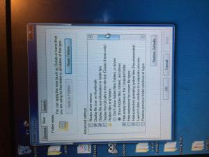

Is your Windows setup to show file extensions? Ie. when you look at a text file in Windows Explorer do you see "<Filename>" or "<Filename>.exe" If extensions are hidden and you changed the name from "Global Emulators (Example)" to "Global Emulators.ini" Windows will see "Global Emulators.ini.ini"

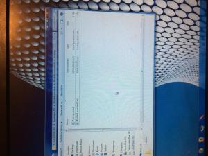

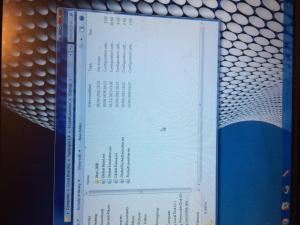

i checked all them and have taken some pics can u check to see if they have the right files in and have u any idea what else could it be tried to install same download onto pc and it does the same if thats any help
Looks normal to me. You could try re-downloading RocketLauncher. If this is a fresh installation the extra ini files in there seem a bit off however. Is this a brand new install?
If all else fails, if you follow this ver batum it'll give us a standard methodology with which to analyze the problem. I suspect it's something simple.

You are better of Hidding your known extensions.
