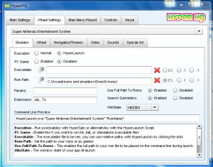

TheMadjai Posted April 19, 2016 Author Posted April 19, 2016 If you have the Roms Only filter on you have to also set the Rom Path and Extensions (separated by commas) in HyperHQ, otherwise it doesn't find any roms and bounces you back. Hmm... closer. Setting these did something. MAME now doesn't bounce me back, but it is only showing me 9 of the 52 roms that Rocketlauncher shows as green. (EDIT: also, at least one of those roms is not a rom I have installed, and throws an error. Seems like pointing RL back to HS like you said did solve the other problem, though, as I can launch Ninja Turtles....) Also, Super Nintendo wheel bounces me back completely.
TheMadjai Posted April 19, 2016 Author Posted April 19, 2016 Ugh. Read the post, Madjai. Ok, when I remove the PERIODS as well as the spaces, the ROM lists are good. However, now MAME and SNES do not fire when I choose a rom. I hit the button to select the ROM, and nothing happens.
