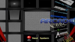

Random5095490 Posted May 10, 2016 Posted May 10, 2016 How do I remove the slight zoom-in on the console image when I select it in the main menu wheel? Running Hyperspin 1.4 with Rocketlauncher

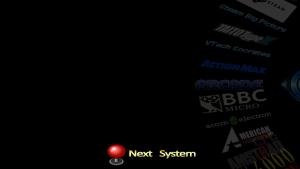

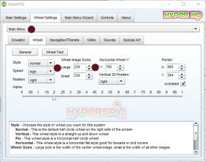

gigapig Posted May 10, 2016 Posted May 10, 2016 You mean from this. To this? Change the Wheel Image Size. Now that I've changed mine, I kind of like it the same.
Random5095490 Posted May 10, 2016 Author Posted May 10, 2016 On 5/10/2016 at 7:15 PM, gigapig said: You mean from this. Image 4.jpg To this? Image 5.jpg Change the Wheel Image Size. Image 2.jpg Now that I've changed mine, I kind of like it the same. Thanks mate! Exactly what I was looking for. Could you help me with my main menu? I want all of my systems to look like this: https://gyazo.com/6e61418a0f13ef53c8f38f4d0ac6a19b How do I remove all the junk on the other systems that do not look like that? "Junk" being the transitions, characters, video not in the box like the other one, and the constant flashing "Free play" https://gyazo.com/0d37fd95bca7805096c013e9129897b2
