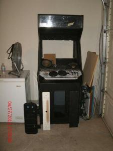

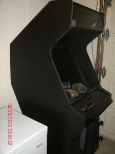

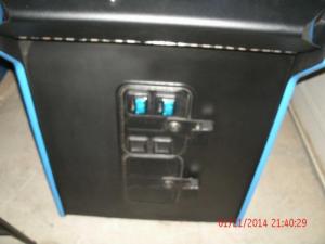

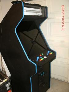

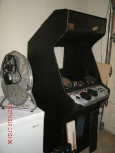

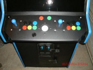

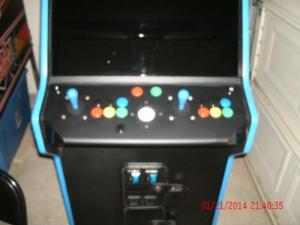

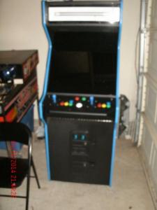

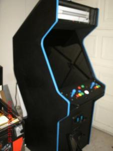

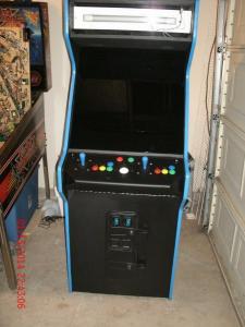

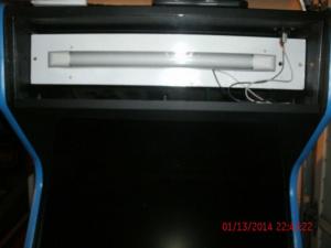

So I've been working on another Koolkade wanted to see what it would look like in a different style cab. It has a 26inch LCD screen. 2 Happ Happ Competition Joysticks 6 button layout. The 2 Black buttons are Concave for the old arcade feel and the rest are Competition Convex buttons. It has a 2 1/4 inch Track ball and only one button which is for the left click. NovaGemCDR™ Coin Drop Replacement Pushbuttons down by the coin mechs. It also has a Keywiz St 40. Over all I like the build I feel it looks very very good.

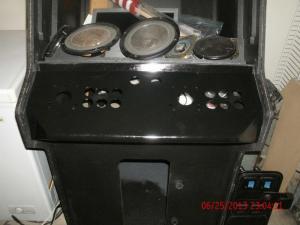

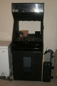

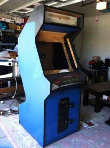

It was a 3-KOAM, INC Z back they were mass produced as a kit to except new jamma kits. They are also known as a Dynamo Z back. They get that name because they have the Dynamo control panel style. So They would say Dynamo Z back. These were everywhere back in the 90's in California. They would put all the street fighter jamma kits in them and a lot of Shooter games. This one was a Police trainer but it was completely gutted. I some how was able to get this cab with the 3 versions of the control panels. I might put the left over control panels up on BYOAC in a couple days.

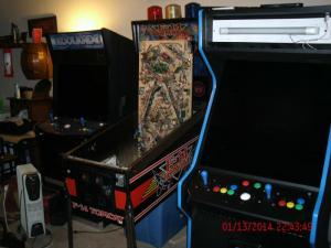

Great cab bro! I have 2 dynamo cabs, but neither z backs... Do you like the happ joys? I can't get used to them, I always revert to seimetsu sticks with octagonal gates
My Arcade Machines...
I love The Happ Competitions. I like the Japan style joys for the Shmup's and certain fighter games because of the short throw and quick movements that are needed. But I can handle almost all with the Happs I just like the feel and I don't have to clean them every couple months they are real work horses.
