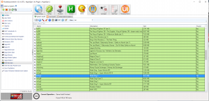

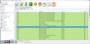

So i have multiple systems already set up including MAME. Rocket Launcher recognizes all my ROMS and will launch from both RL and hyperspin.
I tried setting up neo geo and although it recognizes all ROM's in the database for it it will force close when launched from RL and when in hyperspin it starts to boot but ends up at the selection screen as if nothing happened.
My settings are the same for MAME as they are in Neo Geo.
