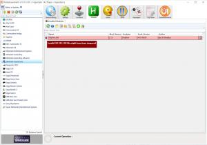

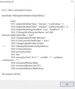

I was putting GameCube functionality on for use within Dolphin and everything was working great - but when adding Ishiiruka as a 2nd option for starwars i noticed an odd error when the Dolphin.ahk had turned red and an error about tampered Dolphin.isd was reported. Games now no longer opened successfully except whilst using Dolphin outside of hyperspin. - so........ i replaced the Dolphin.ahk and Dolphin.isd with the files from the rocketlauncher installer and the errors went away but to my horror - when i try to run a game - i get a little box FULL of Errors.
Error: Call to existent function.
Specifically: HideAppStart(hideEmuObj,hideEmu)
                   Line#
                   1017: dolphinINI.Write("False", "Interface", "ConfirmStop", 1)
                   1018: dolphinINI.Write("False", "Interface", "UsePanicHandlers", 1)
                   1019: dolphinINI.Write(gcSerialPort, "Core", "SerialPort1", 1)
It goes on with 1022 1023 1024 1025 1027 1029 1030 1031 1032 1034 1035 1036 with equally confusing stuff for my confusion.
Does anyone know how i can fix this please?? I still have the files that turned red - the Dolphin.ahk and Dolphin.isd but with these back in their original place - the screen doesnot setup or rather it errors waiting for the screen to be setup.

This is the error with the replaced files from the rocketlauncher install :-

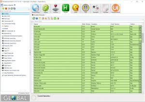

The following pics are of the original issue and the files put back in place for the pics :-
Thanks in advance for any help. I better add - i have tried removing and to re add the gamecube - BUT - the RED Dolphin.ahk and the report about the Dolphin.isd is still there!! I completely lost with this one!!

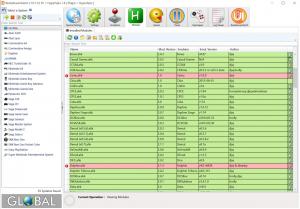

The screenshots you posted show RLUI version 1.0.1.0 and I'm running 1.0.1.4 so there should definitely be an update available for that. Check to make sure that "Check for Updates" is checked on the RocketLauncherUI -> Settings tab under Startup Options. You can force an update check by pressing the button I circled in the screenshot below.
Thankyou so much - i checked and auto update is ticked - but when i forced the update - 150 updates were found and installed.
This has fixed the original red Dolphin.ahk and Dolphin.isd as shown here:-
I now have the following issue :-
BUT - one game did open ok, so it is some silly setting somewhere i dont know about - any help would be greatly appreciated - even a pointer to a relevant tutorial etc.

If the game is loading and you're getting that error message that usually means you're using a different emulator version than the one the module was built around. Therefore, RL can't find your emulator window because it's looking for a different one.
You can either use a different emulator version or get the window title/class of the one you're using and modify the module to look for that instead.

There's a tool called Window Spy that comes with AutoHotkey, which is what I use. Run that tool and when Dolphin is running and has focus it will tell you the window class, title and a bunch of other stuff.
Lol - i chickened out - i googled myself delirious and went and took the 2 yr old Dolphin "stable" version - ALL is running perfect now - tho the progress on Dolphin in sweet as candy!!
Thankyou for the help = ALL is solved now.
