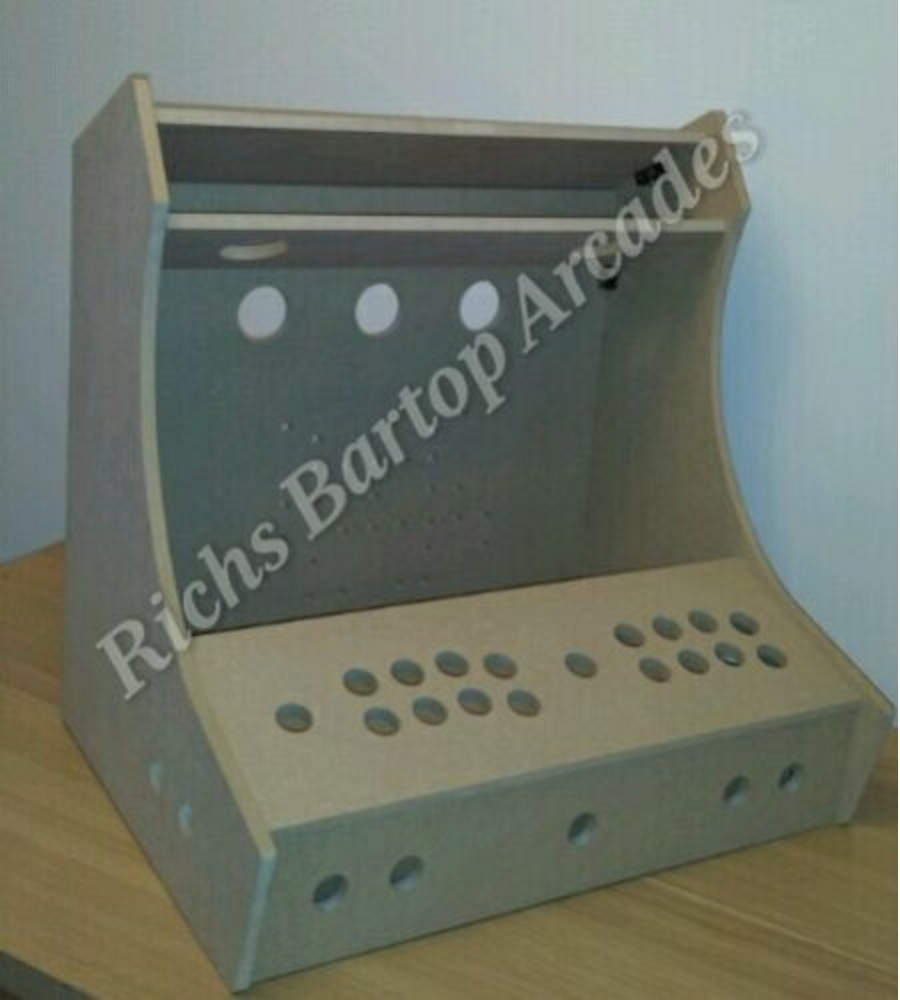

luketraceyuk Posted June 24, 2016 Posted June 24, 2016 Hi All Newbiee question. Does anyone know a alternative for using T-mold for a bartop cab? Mine does not have the ridges to fit the T-mold. It's like the one below. Also has anyone used bezels for a widescreen cab before I cant find much info on that. The screen is set to 4:3 just want to hide the sides.Thanks

madhatter3339 Posted June 24, 2016 Posted June 24, 2016 Do you mean you don't have a slot cut for the t-molding to go into or the t-molding is too wide??? T-Molding.com has 1/2 if that will help. They also have flat trim without the center barb so you can trim it to width!!!
luketraceyuk Posted June 24, 2016 Author Posted June 24, 2016 Yeah no slot, cheers Sent from my SM-G920F using Tapatalk
Goodboyparker Posted July 2, 2016 Posted July 2, 2016 You may look for plywood veneer edging. Generally it is an iron on and it can be trimmed with a hand knife or scissors. I have used it on the edge of shelves and it is easy to work with. A 25 foot roll is about $10 in the US. If you aren't happy with the results it isn't a ton of money...
