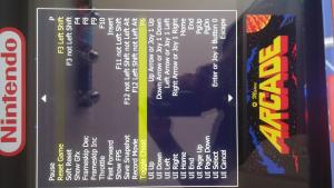

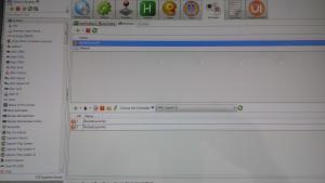

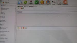

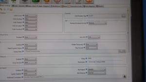

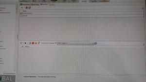

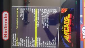

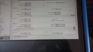

C4K Posted July 1, 2016 Author Posted July 1, 2016 Hi Guys thanks for help, will check it out now an update you guys with my progress. i have 180 systems as my kind friend let me clone his drive, but he uses his setup on laptop with xbox controllers using xpadder, were as i have an arcade cab, i asked him first but he has never used ipac so i am stuck and being a novice it is very difficult to take in, will check out What is the key assigned to exit mame (you will find this by using the tab key) this now, also in RL i done the following please see see images as this is were i have been messing trying to resolve also i remapped within ipac settings so not sure if this will of done anything, is there away to reset the ipac to factor settings if needed? cheers guys..
