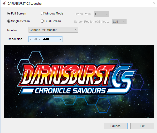

majorspawn Posted July 2, 2016 Posted July 2, 2016 Hi Guys, Has anyone managed a way to bypass the DariusBurstCS loader window at startup of the game? This is the first screen you see before entering the game My Arcade Projects: SNES PC Project Vewlix Cabinet LS-30 Rotary Joysticks

gigapig Posted November 26, 2016 Posted November 26, 2016 On 11/25/2016 at 11:00 PM, agent47 said: Is it an RL error or the game throwing an error? You may have better luck catching the error message by recording video and playing it back super slow if it pops up and disappears quickly. Expand It's not that quick I'm just a slow reader. All sorted anyway, the window name has changed or is different on my version. It's now... Darius Burst Chronicle Saviours for Steam (Rev.5782) ahk_class Darius Burst Chronicle Saviours for Steam (Rev.5782) So the main thing is it works but I'd love to know why that script needed to be so complicated, I've scripts that just send "Enter" which is all that I would do to start the game, press Enter. Anyway the old script I have did not work but this does so all sweet.

gigapig Posted November 26, 2016 Posted November 26, 2016 On 11/26/2016 at 2:45 PM, agent47 said: For similar launchers, yes. You would need to change the LauncherWindow and GameWindow variables but also the Button1 variable in line 24. You would have to use something like WindowSpy (which comes with AHK) to grab all that info. You could also modify that line to just send Enter after the launcher has focus instead of clicking a button. It's not that complicated, although it is a lot more complicated then sending enter. It basically waits for the launcher window, if it doesn't appear it throws an error and if it does it clicks the Launch button. Then it waits for the game window to show, throws an error if it doesn't and if it does sets focus to the game window. Doing it this way makes sure that the launcher and game windows get focus when they need it and throw errors if something goes wrong so you know what to check. If you just sent enter you may need to delay the press on different machines if they take more/less time to boot the game and if something were to steal focus it would mess things up. Expand Wonderful, thank you.
