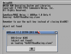

Hi Ron,
Hoping you can help me out again. I'm onto Amiga now, and followed your guide step by step twice over. When I execute the games either via HLHQ or HS I see WinUAE load and the banner for the game and right after just like any game, black and white bars across the screen, flashing and seems to be rebooting. Any Ideas my friend?
Thanks in advance.
Jonathan

Jonathan,
I have heard of other users having simular issues. Most of the time it's due to either a bad WHDLoad key or bad boot/os roms.
Can you post your WinUAE log files (using code tags, as always)?

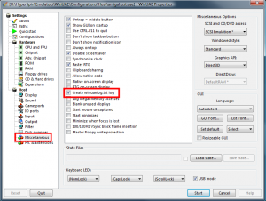

As a default both logs are not enabled in WinUAE, so here is how to enable the winuaelog.txt:
Launch WinUAE (outside HyperSpin and HyperLaunchHQ).
Click on Configurations on the top left.
Hit the Load From.... button on the bottom.
Double click on Host and load your amigahost.uae file.
Now, click on Miscellaneous on the left. Check the box next to Create winuaelog.txt log:
Now to save the config.
Click on Configurations on the top left again.
Hit the Save As... button on the bottom.
Double Click on the Host directory and again, double click on your amigahost.uae file.
When asked to overwrite, click Yes.
Now, hit the Quit button on the bottom left.
[ATTACH=CONFIG]40404[/ATTACH]
Launch a game through HyperLaunchHQ or HyperSpin and post the contents of your winuaebootlog.txt and winuaelog.txt files here.
Thank you,
Ron

Good news and bad...
The good:
Both your log files look good.
The bad:
As I suspected, it is your WHDLoad.key file.
I replaced my legal purchased key file with one found on the "InnerWebs" and I get the exact same results that you do.
I put my key file back and the game boots fine.
Thanks,
Ron

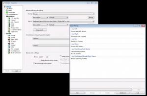

First: THANKS! I was close to give up with WinUAE then I found your outstanding guide.
But it is still a mess for me how to configure keys.
I got an arcade cab with I-PAC and keys as below:
Joy up --> up arrow
Joy down --> down arrow
Joy left --> left arrow
Joy right --> right arrow
B1 --> Z
B2 --> X
B3 --> C
B4 --> V
B5 --> B
B6 --> N
and WinUAE inputs are default configured as in the pic below:
[ATTACH=CONFIG]40583[/ATTACH]
But still I cannot change them as I want, I double click on each of them, nothing happens.
For example double click on "CRL destra TASTIERA" (control right keyboard) doesn't let me change it.
Am I doing something wrong? Am I in the wrong config tab of WinUAE?
Maybe there is a way to change them directly editing the ini or uae file?
Thanks for help.
Agreed, the controller mapping function in WinUAE is funky.
Hit the button at the bottom of that screen that says "Delete All" and then hit the "Remap" button.
Thanks,
Ron
